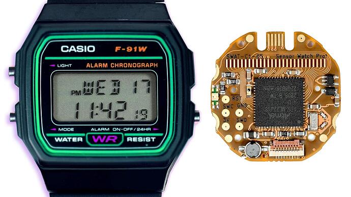

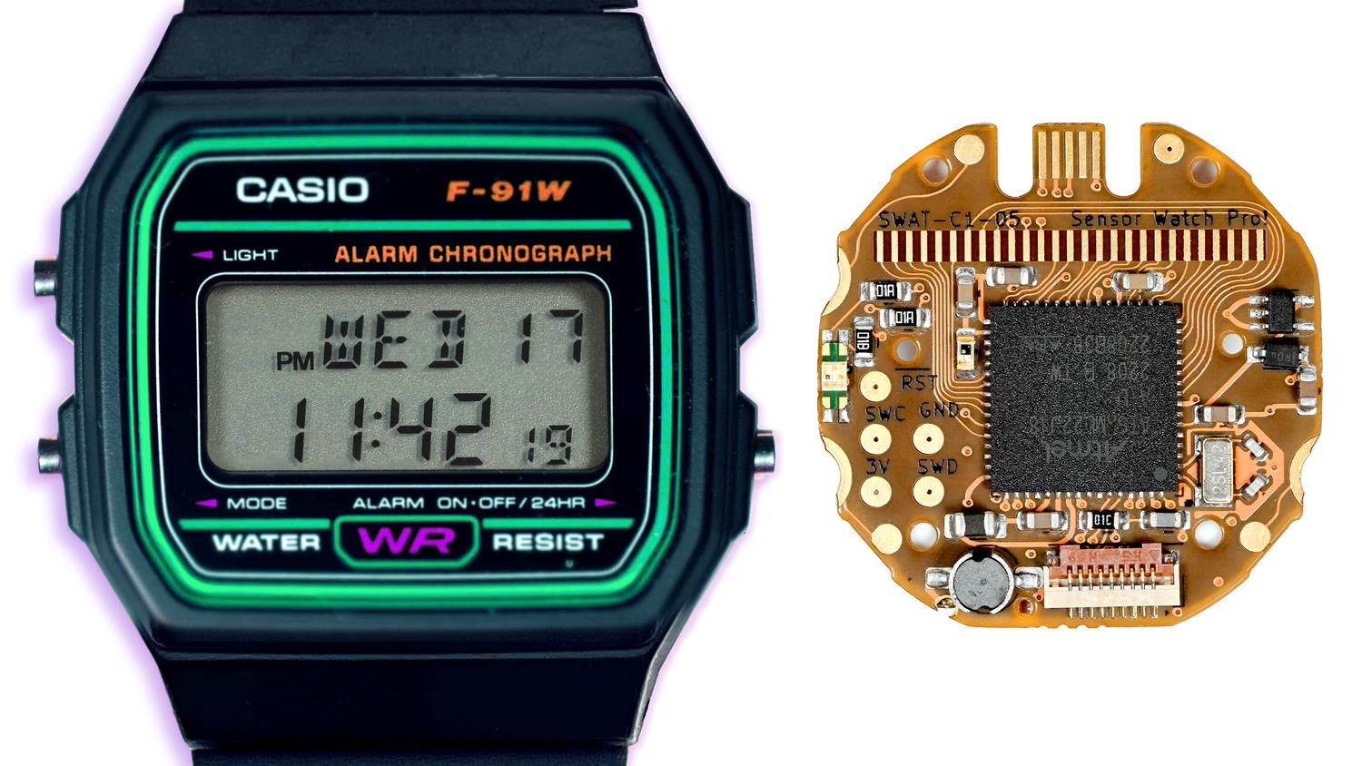

The classic Casio watch, with a custom board and firmware, adding features.
Does it run Android? :eyes:
No, it uses a micro-controller, not anywhere near powerful enough for Android.
What would you even do with Android on a device with a segmented display?

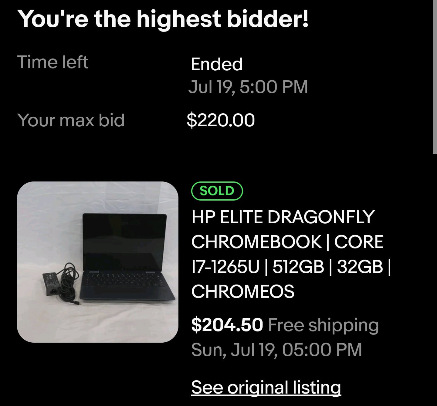

Just snagged one of these:
You can run Linux on it in one of two ways, mrchromebox.tech (requires $7ish dollar dongle to disable write protect), or submarine (you can Google).
You can run Windows on it as well. Drivers needed for audio and usb4 are paid from coolstar.org
Technically a t14 gen 1 Ryzen 7 4750u is better multicore, but this screen (3:2 - 2256 x 1504) and form factor (and it’s better single core as well)! Besides for the fact that it already comes with 32gb RAM, and at that price.
This seller on eBay is:
Really good deal for the hardware. Just a little work.
M2 is replacable

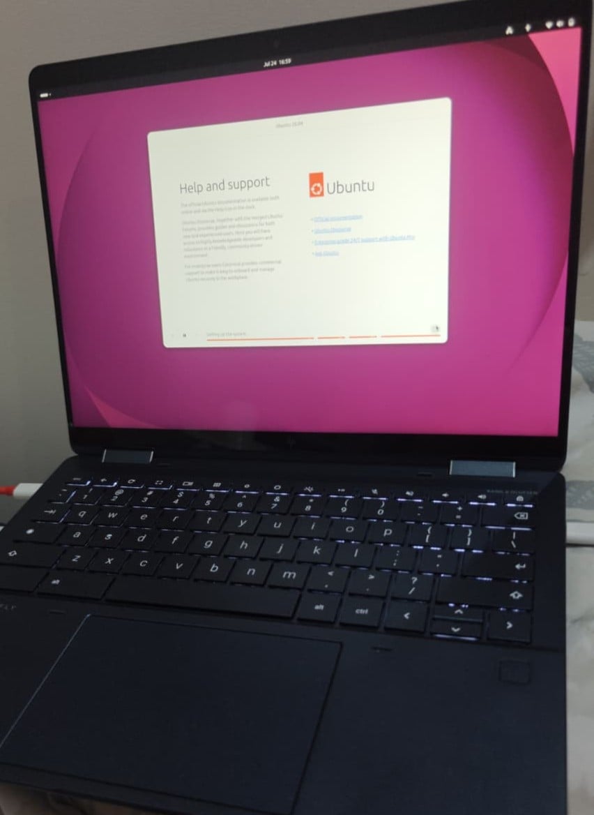

Got the laptop, feels really premium, screen is a bit glary in the light, will buy some sorta anti glare screen protector if it bothers me too much.
Got everything (besides one of two things I’m not sure I care about) working on Ubuntu 26.04. if anybody actually buys it I’d be happy to help. You can install Windows as well but need to pay for some drivers.
Keep in mind one thing though, it’s a battery lottery, mine came at 78%.
There are better options if you want more raw power too, but I considered all of that before I bought it. Great for me.
