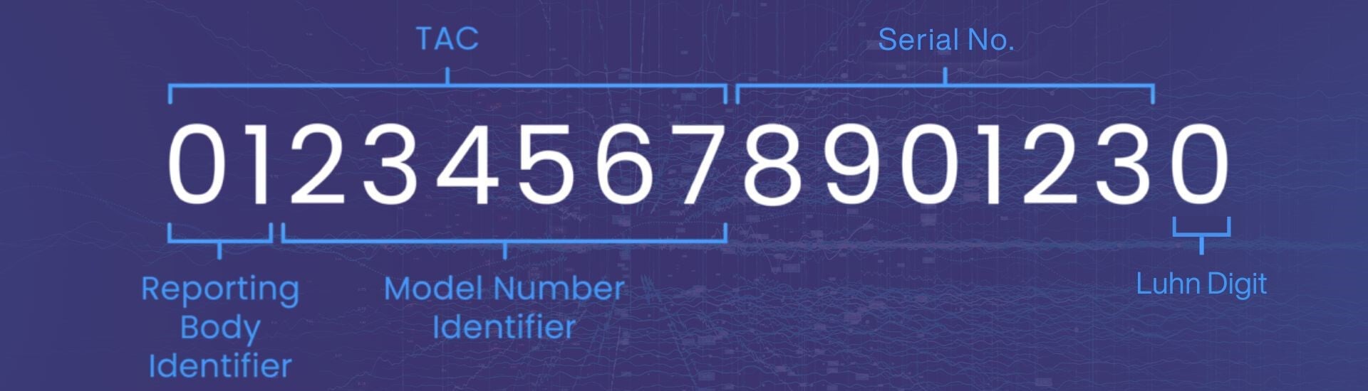

Additionally, thought it would be nice to add an IMEI generator to the app, going to dump my research here.
Graphic credit imei.info link below
IMEI is structured in 3 parts:
  1. TAC (Type Allocation Code) First 8 Digits. The first two digits identify cert. region (01 is US), next 6 identify manufacturer and model. For instance, all Kyocera E4810 should start with 01558800, 01 for USA, 558800 for Kyocera E4810.
  2. SNR (Serial number) 6 digits that uniquely identify your device.
  3. CD (Check Digit) 1 digit that is calculated from the preceding 14 using Luhn (mod 10) algo. (Implemented in attached python script)
Info on the structure of IMEI mainly from here:
