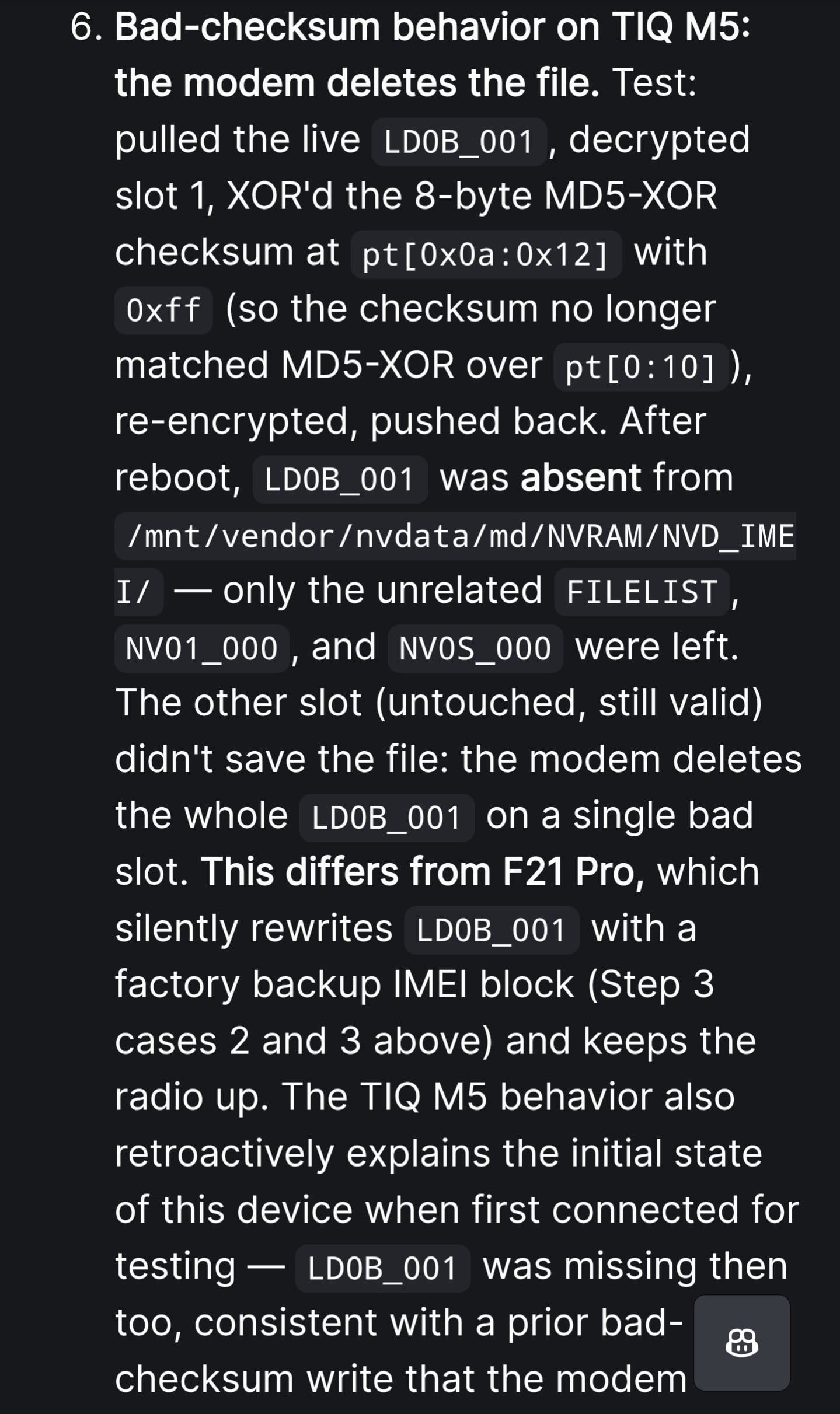

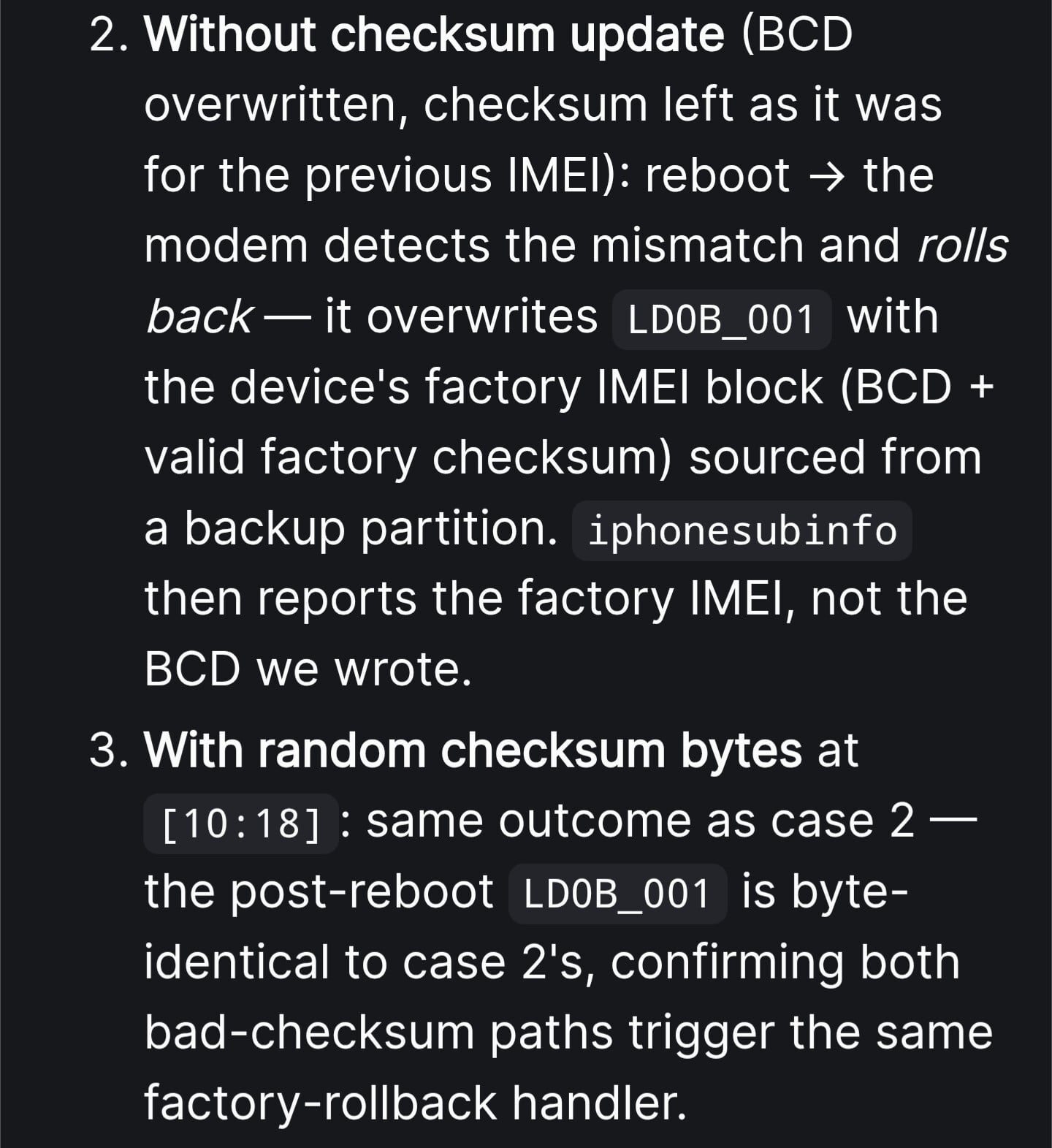

If you delete the entire /mnt/vendor/nvdata/md/NVRAM/NVD_IMEI/, depending on the phone, it should reset back to factory.
Can it make damage on some devices?

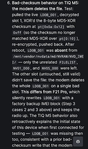

From what I see on the tiq m5, there is no reset, will just boot with nothing. Don’t know about the f25. 99 percent sure it works on the f21 pro. One sec
If it’s not something that works across the board, maybe it’s enough what I just added. I don’t wanna add more features that will confuse users when it has different behaviors that are undocumented
From the original RE with f21 pro.
M5:
Disregard the bottom, it was empty because of spflash format and download and cc made an false inference. Didn’t matter for the docs so I left it there.
