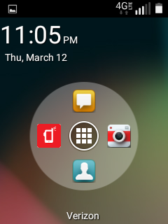

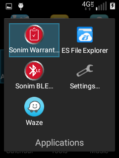

Runs android 5.1.1. Its able to run android apps, but you can only install apps with adb, I was able to get to developer options and turn on USB debugging and install and use some simple apps, like waze. The settings app is very simple, not a lot to do there. The battery is very good, it does not charge very fast though, and the software is obviously really old at this point

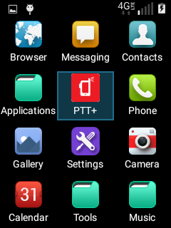

Stock apps:
  • Has all the apps you need on a phone. Clock, music player, camera, recorder, file explorer, music player, some sonim apps like backup and restore, and a few more

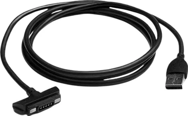

  • This one uses sonim’s magnetic proprietary charger (they don’t use it for almost 10 years already), the newer (XP5800) uses USB-C

  • its using a charger that almost zero other phones use

what charger is this? Can you post a picture?
