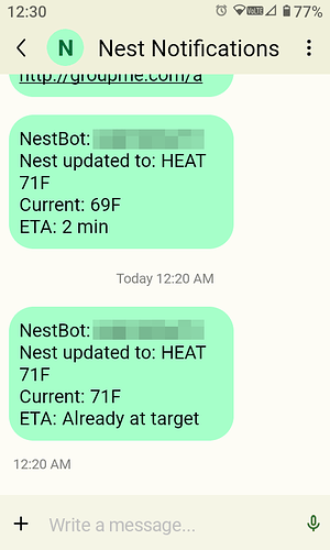

Overview
This setup allows you to:
  1. Send an SMS to a Google Voice number.
  2. Google Voice forwards the SMS to Gmail.
  3. Google Apps Script reads Gmail, parses the temperature command, and:
    • Updates your Nest thermostat via Google Smart Device Management (SDM) API.
    • Posts a confirmation message to a GroupMe group via a bot.
Workflow Diagram:
Your Phone → Google Voice SMS → Gmail → Google Apps Script
                    └──────────────→ Nest SDM API (Set Temperature)
                    └──────────────→ GroupMe Bot (Confirmation)

Setup:
  1. Save → Run processSMS → Authorize (Gmail + external URLs).

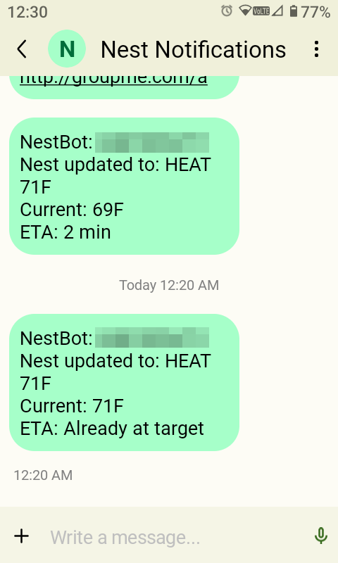

  1. Text your Google Voice number: 72.
  2. Within 2 minutes:
    • Nest updates to 72°F.
    • GroupMe posts: :white_check_mark: SMS +1-555-123-4567: Nest → 72°F (22.2°C) heat.
    • Gmail email gets nest-processed label.
Commands:
Input Result
72 72°F Heat or Cool - depending on current setting :white_check_mark: Tested and working
heat 75 Heat 75°F :white_check_mark: Tested and working
cool 68 Cool 68°F :white_check_mark: Tested and working

Change Log – 12/28/25
  • Fixed Cool {temp} and Heat {temp} commands.
  • If the requested temperature already matches the current setting, the script now confirms the temperature is set.
  • Improved feedback to include:
    • Set temperature
    • Current temperature
    • Estimated time to reach set temperature (ETA) added
  • All sensitive values (Google OAuth credentials, Nest device ID, Google Voice address, and GroupMe bot ID) have been moved to Script Properties for improved security.

The script has been improved with the following changes (see updated script above):
  1. Fixed Heat and Cool commands – The heat {temp} and cool {temp} commands now correctly update the Nest thermostat mode and temp.
  2. Current temperature feedback – When a command is sent, the response now includes:
    • Temperature that was set
    • Current temperature reading from the Nest
    • Estimated time (ETA) to reach set temperature
  3. Confirmation if temperature already matches – If the requested temperature already matches the current setting, the script now confirms that the thermostat is already at that temperature.
  4. Improved Security – All sensitive values (Google OAuth credentials, Nest device ID, Google Voice address, and GroupMe bot ID) have been moved to Script Properties for additional security.
These changes improve accuracy and make the feedback much more informative when controlling your Nest device via SMS.
