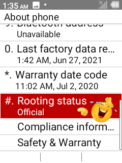

made both wiki so you could edit it
@BenTorah excellent work! Gold Medal!

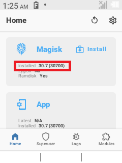

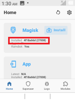

For some reason latest versions of magisk refused to repack on the E4810. In your screenshot you seem to be using version 30.7 (latest). @ars18‘s screenshot from last year uses version 29, most likely latest at that point. I tried 30.7 and 30.2 but it just hung indefinitely on repacking. Went back a bunch to version 27.008 and it worked.
Any idea?
You can either let it hang for a while and it should finish, or patch on pc.
Ty - i’ll try it again…
