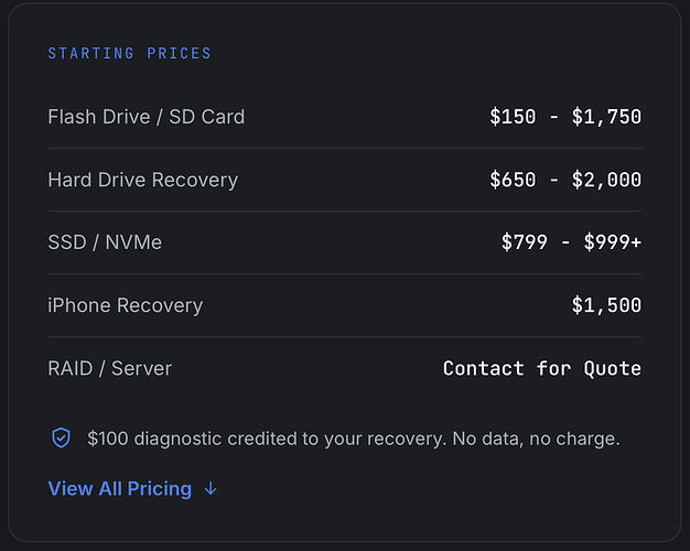

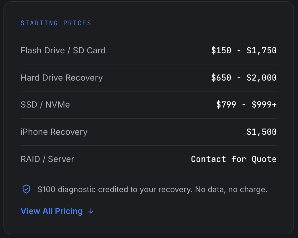

You can always try a data recovery place if he’s willing to pay $$$$
He’s willing to pay hundreds.
I assume that that’s well below what this would cost, right?

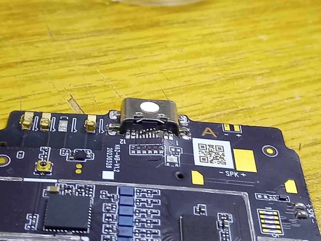

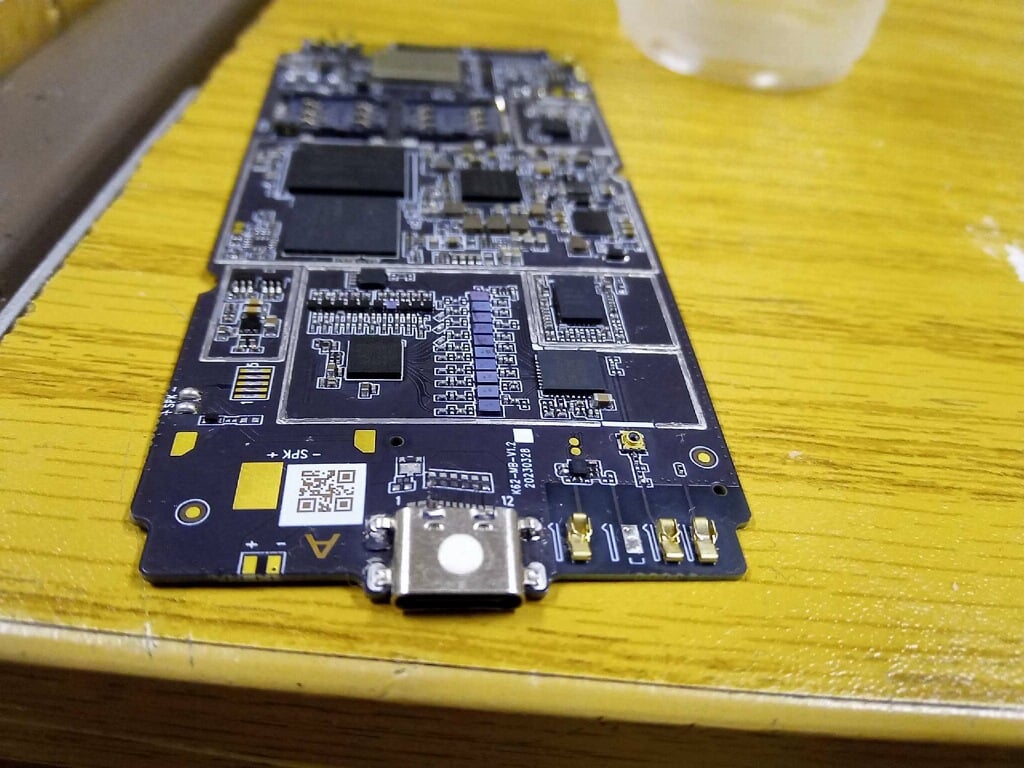

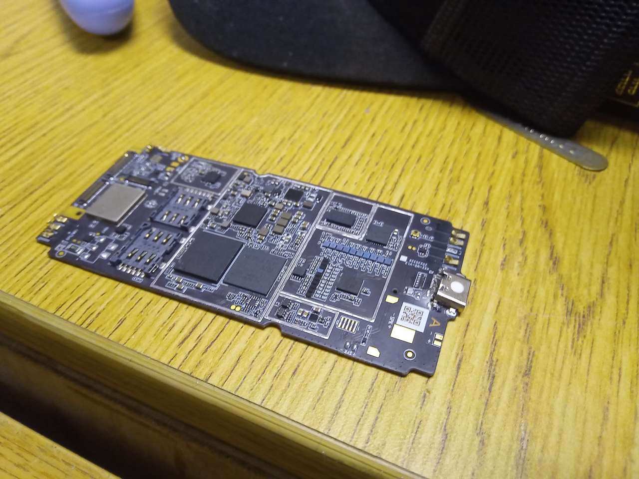

This is what it looks like right now:
What’s broken
Type-c port is broken.
That wont be cheaper to fix? I have no idea honestly
Is it only the type C which is broken or also the motherboard? U could fix the C charger for around $50 by any smartphone repair shop.

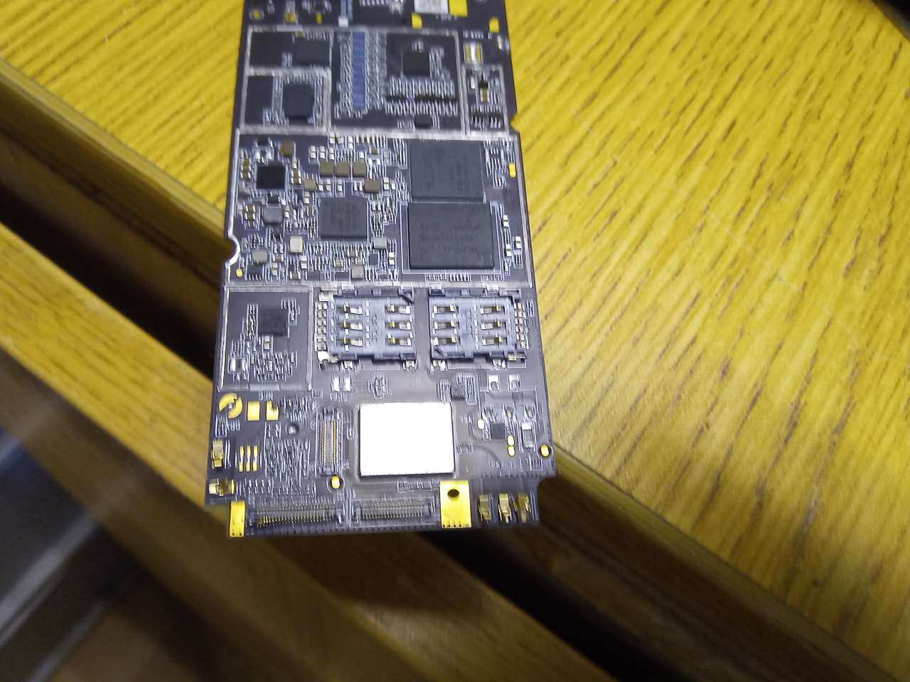

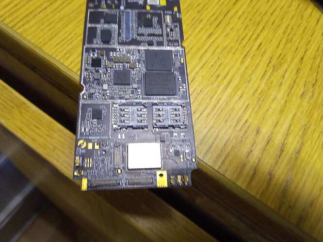

Hundreds might not be enough, if they have to desolder the chips from the motherboard and do who knows what to access the data. Probably not recoverable at any reasonable price, but you might get lucky.
Is it just the part of the motherboard that has the wiring for the USB port that’s broken, or are these other parts too? Because if it’s just the USB part, why can’t you connect a charged battery and a screen and back everything up via Bluetooth?
Or, if there aren’t too many tiny contacts on the memory chip, you might be able to unsolder it from this motherboard and solder it onto another fig motherboard.

Usually what they do for data recovery even if it’s encrypted. I know with iPhones you need to take the NAND storage the processing SOC and the secure enclave and solder it to a donor board.
I don’t know if figs have a secure enclave equivalent but if it’s encrypted, I would imagine it at least needs processor and nand to be moved.
If it’s not encrypted, you could probably just de-solder the nand and put it into a chip programmer. Pull the flash contents and work with it that way using binwalk and other tools
