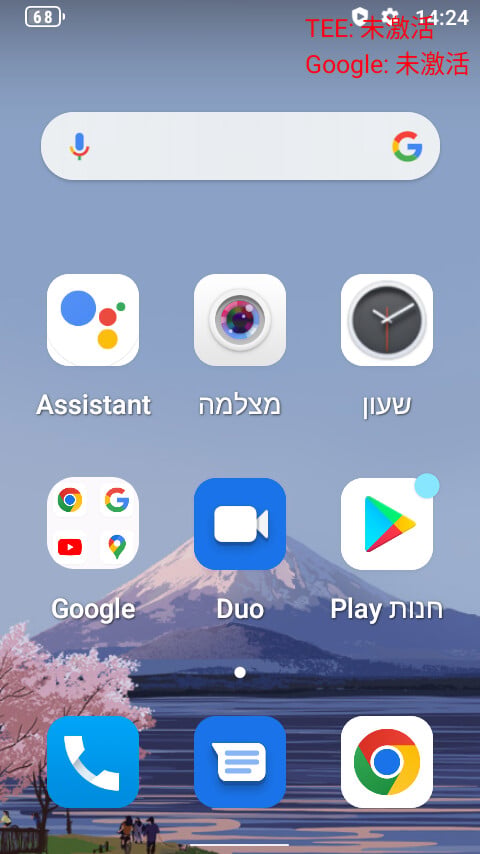

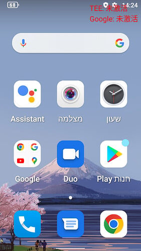

If you encounter a screen like this after flashing
 ![image](https://jtechforums.org/uploads/default/original/2X/b/b63787649da38345517abad2a8eb57011076ca1e.jpeg)
 ![image](https://jtechforums.org/uploads/default/original/2X/f/fefa0b385bfca6467cfa31847720d7fa194d9a44.jpeg)
Go to settings, first line My Device, and press 5 times in a row on the top right button called jelly star.
This is sometimes caused by flashing a European ROM on a global device or vice versa.
This solution only works on Jelly star
On other models you need to edit the build.prop
