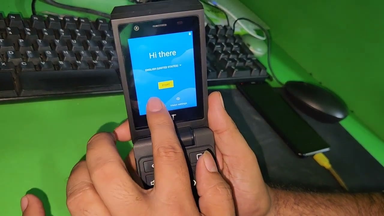

**Author:** ![Nooch](https://jtechforums.org/user_avatar/jtechforums.org/nooch/32/7965_2.png) [@Nooch](https://jtechforums.org/u/Nooch)\
**Post date:** [September 7, 2026, 4:54pm UTC](https://jtechforums.org/t/reset-password-on-cat-s22/8526/17 "2026-09-07T16:54:00Z")
[![](https://jtechforums.org/uploads/default/original/2X/2/28ce2c2323e071955c69aaaaea386c7e71f0de0f.jpeg "Cat S22 Flip FRP Bypass Android 11 Without PC - cat s22 flip frp bypass - cat mobile frp bypass") ](https://www.youtube.com/watch?v=-eI8Ak7am2s)
Here’s a video explaining how to do it
**Author:** ![Yitz](https://jtechforums.org/user_avatar/jtechforums.org/yitz/32/13411_2.png) [@Yitz](https://jtechforums.org/u/Yitz)\
**Post date:** [September 7, 2026, 5:05pm UTC](https://jtechforums.org/t/reset-password-on-cat-s22/8526/18 "2026-09-07T17:05:01Z")
Nice Video! different method that i used keep in mind that sometimes google patches it
